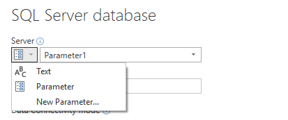

Based on my test, We cannot change data source of a report from Power BI service. Here we can use parameter to change data source.
Then we can get data using the Parameter that we created. In power query we can get different data of different data sources by changing the Current value.For more details, please check the online document.
Here is the M code for your reference.
    Source = Sql.Databases(Parameter1),
    Power_BI_Test = Source{[Name="databasename"]}[Data],
    dbo_Financial_1 = databasename {[Schema="dbo",Item="Financial_1"]}[Data]
    dbo_Financial_1
    dbo_Financial_1
