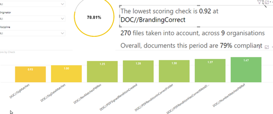

I want to create a measure to get the smallest average taken from a list.
Two screenshots below, show the data format and the visual I have taken.
I now want to use a measure to get the '0.93' value so that I can use it on a card.
I'm unsure how to do so.
Any help would be appreciated.

I have run this calculation however it just gives me the average of '1.6', instead of the lowest average by check
Measure = MINX(ALL(table),[AVG_value])

I can't seem to find what I'm looking for.
Please see the sample attached: https://www.dropbox.com/s/euz78g6444lfmrl/Compliance%20Reflection%20-%20sample.pbix?dl=0

Now I've got a follow-up question.
I'm using the 'Enlighten Data Story' visual.
Is there any way to link the score to the check?
My hope here is that it would say that it's x score for x check.
Does this make sense?
Many thanks for your help thus far.

Hi @CoreyP
That will work in this instance however this will be a live report with new data being pushed through periodically, meaning that the lowest average will change from DOC//SigMatches
