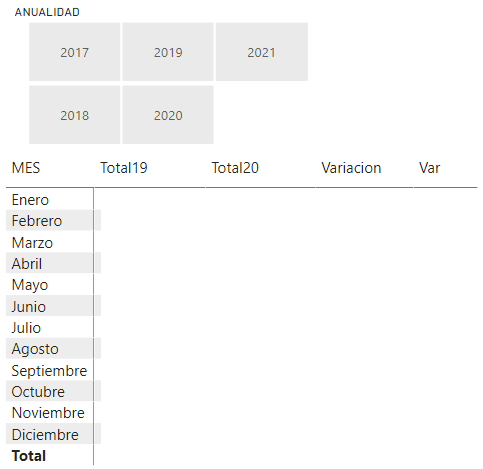

I have a table in which I use some measures to realize the total, difference and variation between two years. When using DAX measures the annuities passed them as a fixed value in each of the calculations, I would like to be able to select the year for one column and independently the year for another and perform the calculations.
I put a screenshot and try to explain myself better:
In this table where you put Total19 and Total20, I calculate them as follows:
Total19 - CALCULATE([Total], DATA[ANNUALITY]- 2019)+0
Total20 - CALCULATE([Total], DATA[ANNUALITY]- 2020)+0
I would like those totals to take them depending on the year I took for each of the two columns, and to automatically perform the calculation of variation and difference
Variation - Total20 - Total19
Var - DIVIDE([Variation], [Total19])+0

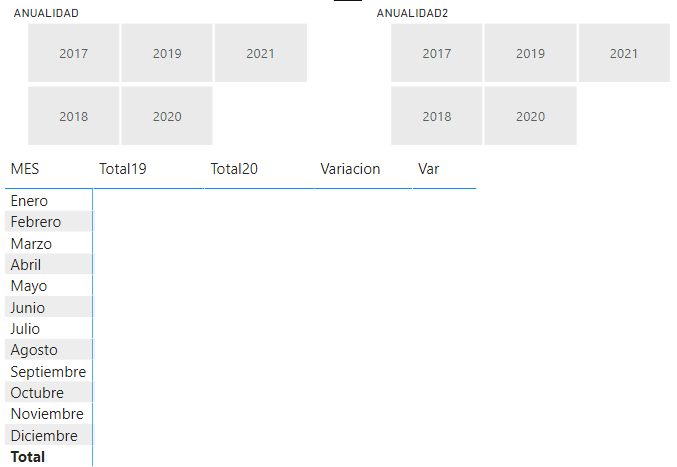

The idea would be to look like this, to select two years:
All the data I have in the same table, I have an annuity field, I also have in that table a date field (DDMMAAAA).

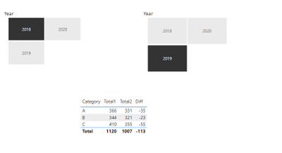

v-yingjl
Don't @Syndicate_Admin,
You must extract the year column as a seprate table:
Year table = DISTINCT('Table'[Year])
Create measures like this:
Total1 = SUM('Table'[value])
Total2 =
    SUM ( 'Table'[value] ),
    FILTER (
        ALL ( 'Table' ),
        'Table'[Year] = SELECTEDVALUE ( 'Year table'[Year] )
            && 'Table'[Category] IN DISTINCT ( 'Table'[Category] )
Diff = [Total2] - [Total1]
Attached to a sample file in the following, you hope it could help.
Best regards
