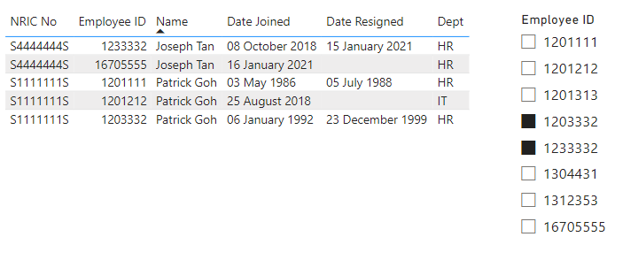

hi @Patrick_Goh_YY
try the following:
1) plot a slicer based on a calculated table like:
Slicer = ALL(data[Employee ID])
 2) plot a table visual with all the columns, but filter the visual with a measure like:
measure =
VAR _no =
MAXX(
    FILTER(
        ALL(data),
        data[Employee ID]=SELECTEDVALUE(Slicer[Employee ID])
    data[NRIC NO]
IF(
    MAX(data[NRIC NO])=_no,
    1, 0
choose 1.
it worked like:

Hi @Patrick_Goh_YY
Please refer to attached sample file with the proposed solution
FilterMeasure =
VAR EmpNames =
    CALCULATETABLE (
        VALUES ( 'Table'[Name] ),
        'Table'[Employee ID] IN VALUES ( Employee[Employee ID] ),
        ALL ( 'Table' )
    COUNTROWS (
        FILTER (
            'Table',
            'Table'[Name] IN EmpNames

hi @Patrick_Goh_YY
try the following:
measure =
VAR _no =
MAXX(
    FILTER(
        ALL(data),
    data[NRIC NO]
IF(
    1, 0
choose 1.
it worked like:
