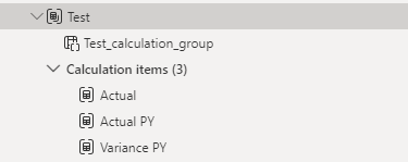

I created a Test calculation group:
With Calculation items:
1) Actual
2) Actual PY
3) Variance PY

3. The calculation items don't look right.
Sample screenshots:
Sample screenshots:
