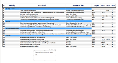

I am creating a score card that I have pulled off You Tube.  I have the sample BI to copy and have benn doing great until now.  I am  trying to add a symbol column .  The DAX works well until I try to add  selectitem 12 that involves a %.     Here is the DAX  below:
Icon =
VAR SelectItem = SELECTEDVALUE('KPI Score Card'[Row Index])
Return
SWITCH(TRUE(),
SelectItem IN {1,9,13,17}, "",
SelectItem = 2 && [Overall Sastifaction 2024] <= 4.5,"▲",
SelectItem = 2 && [Overall Sastifaction 2024] > 4.5,"▼",
SelectItem = 5 && [Overall Sastifaction with current position] >= 4.5,"▲",
SelectItem = 5 && [Overall Sastifaction with current position] < 4.5,"▼",
SelectItem = 7 && [CP Communication with Classic] >= 4.5,"▲",
SelectItem = 7 && [CP Communication with Classic] < 4.5,"▼",
SelectItem = 10 && [Attention to safety] >= 4.5,"▲",
SelectItem = 10 && [Attention to safety] < 4.5,"▼",
SelectItem = 12 && [Classic prioritizes overall safety] >= 0.90,"▲",
SelectItem = 12 && [Classic prioritizes overall safety] < 0.90,"▼",
UNICHAR(9724)
 This is my visualization
The DAX that I am using for row index 12 [2023] is "
Selectitem = 12, FORMAT([Classic prioritizes overall safety], "00%"),"  (this is a text format)
Why is the DAX not working as soon as I add selectitem 12?
The error code says:   Calculation error ....do not support comparing values of type Text with values of Type Number.  Consider using the VALUE or FORMAT functionto convert one of the values.
Please help.

    It is refering to this?
