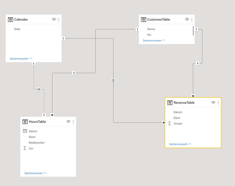

I have the followin tables:
And the following Active relation ships:
Calender(Date) -> RevenueTable (Date) - 1 to many
HoursTable (Customers) -> RevenueTable(Date) - 1 to many
CustomerTable(No) -> RevenueTable(CustomerNo) - 1 to many
An inactive relationship is:
Calender(date) - HoursTable(Date)  - 1 to many.  ((when I activate this one, an error messag pops up. Because I have a Dutch language package of Powerbi I cannot easily translate this one, but it sayas something like "There cannot be a direct active relationship, because that will cause a "double something" between table CustomerTable and RevenueTable...."

The data model looks like this

However, in my supplied .pbix report, the relationship between Calender and HoursTable is 1 to 1.
However, I've the hourstable has more data with some rows with the same date, the outcome is not correct.
The initial post is ofcourse closed (with for that particular) case the right solution. Should I create a new post with this new question?
@Graham_00
This is not sn optimum solution anyway. However, the cardinality of the relationship betwmeen Calendar and HoursTable is not an issue as long as Calendar filters HoursTable. Actually it should be easier as now the inactive relationship between HoursTable and Customer Table can be active and no need to use USERELATIONSHIP
I changed the relationship from 1:1  to 1 to many and activated the relation between Customer table and Hourstable.
