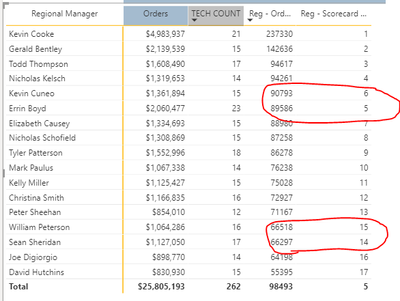

I am trying to RankX the regional manager of each team; however, manager have different size teams and hence higher sales. What I am trying to do is average out their sales / headcount and rank that; however, I am running into several spots when filtering by the month that some of the rankings are out of order, see pics. Any help is much appreciated.
I have it figured out. I am pulling head count from an employee table and order values from an order table for the average. I had to change the relationship on my tables to filter both. Previously the employee table was filtering the order table.

@Dhutch909 , I can see a change in measure calculation when it has been used in Rank. Measure Rank is sensitive to context.Please use exact same measure at both places and check

@amitchandak I am not 100% sure what you mean? The Reg - Order Average uses the number of employees for each manager to get an average and then the Rankx compares the managers averages against each other. Is something wrong with that?
