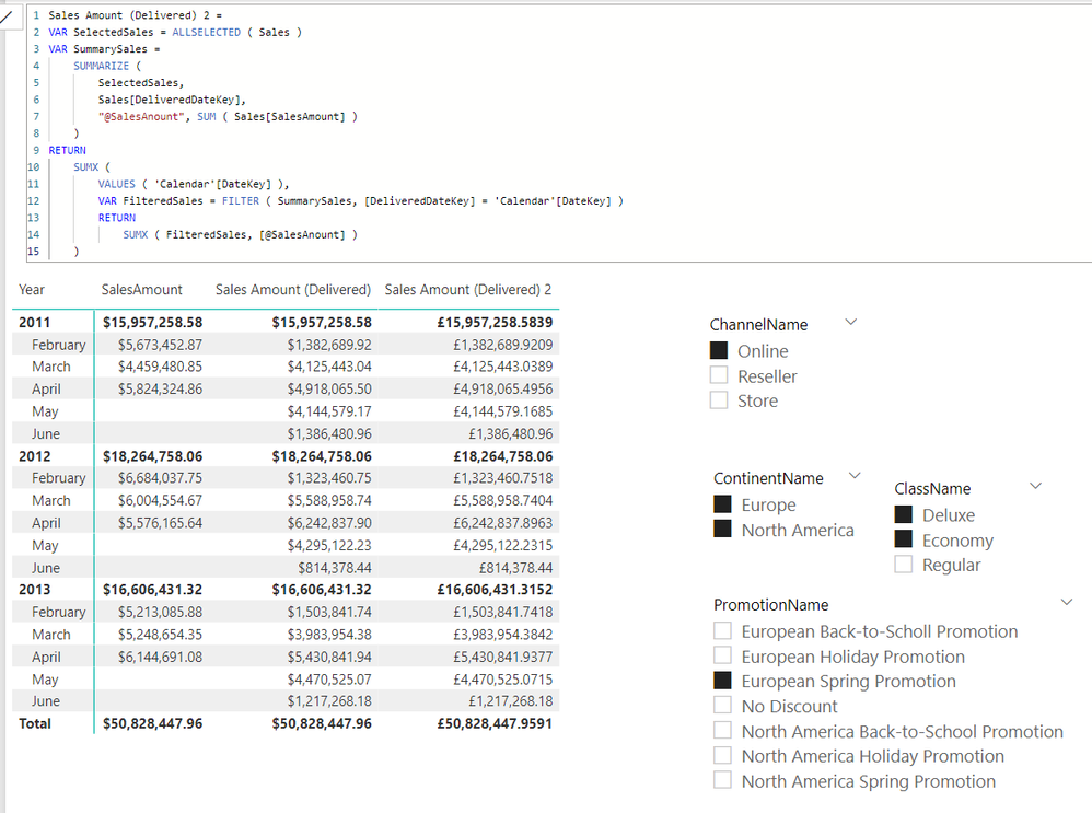

tamerj1
Hi @AlexisOlson  & @Greg_Deckler
This one uses neither CALCULATE nor CALCULATETABLE and performs faster than the original one
Sales Amount (Delivered) 2 =
VAR SelectedSales = ALLSELECTED ( Sales )
VAR SummarySales =
    SUMMARIZE (
        SelectedSales,
        Sales[DeliveredDateKey],
        "@SalesAnount", SUM ( Sales[SalesAmount] )
    SUMX (
        VALUES ( 'Calendar'[DateKey] ),
        VAR FilteredSales = FILTER ( SummarySales, [DeliveredDateKey] = 'Calendar'[DateKey] )
            SUMX ( FilteredSales, [@SalesAnount] )
AntrikshSharma

@tamerj1 I tried and your code and it returns incorrect subtotals.

@AntrikshSharma
Yes you are right I've over looked that but this is an easy fix. The outer SUMX should have been a MAXX
Cumulative Sales Amount (Delivered) 2 =
VAR SummarySales =
    SUMMARIZE (
        SelectedSales,
VAR SummaryDates =
    SUMMARIZE (
        'Calendar',
        'Calendar'[Year],
        'Calendar'[MonthName],
        "@MaxDate", MAX ( 'Calendar'[DateKey] )
    MAXX (
        SummaryDates,
        VAR FilteredSales = FILTER ( SummarySales, [DeliveredDateKey] <= [@MaxDate] )

tamerj1
VAR SummarySales =
    SUMMARIZE (
        SelectedSales,
    SUMX (
