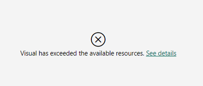

I have a measure with multiple if statements that is crashing my visual. Is there a way to optimize the formula? There are 7 if statements in total, not sure how to break them out into individual measures as they are dependent on each other to produce the end result:
IF(EG38=1,IF(ABS(EF38)<=$EM$2,EE38,IF(ABS(EF38)>=$EM$2,MIN(208,MAX(EE38,EB38)))),IF(EJ38<$EM$4,104,IF(EK38<$EM$4,52,IF(EL38<$EM$4,26,IF(ABS(EF38)<$EM$2,EE38,IF(ABS(EF38)>$EM$2,MAX(EE38,EB38)))))))
Any suggestions would be greatly appreciated!!!

Thank you for the quick response! I transposed the switch option and still get this msg when I try to apply it to a table visual: Any other suggestions?
Can you try creating a calculated column to compute this?
I assume the field (EB38, EE38, EF38, EG38, EJ38, EK38, EL38) are from the same table?
I was actually told in another thread that I should not create a calculated column from measures. Why is this?
It depends. A calculated column uses runtime resources -compute power and in-memory space. If this can be optimized as much as possible within resource constraint, why not? The alternative is to rethink your semantic model and streamline your data architecture. Are you using a star-schema or snowflake model? Have you explored merging the two tables into one to reduce your join and moving between tables? All these require looking into your overall design again for opportunities to improve the performance.
@Olabanjik - I converted this to a calculated column and i no longer get the resource error. Thank you!
