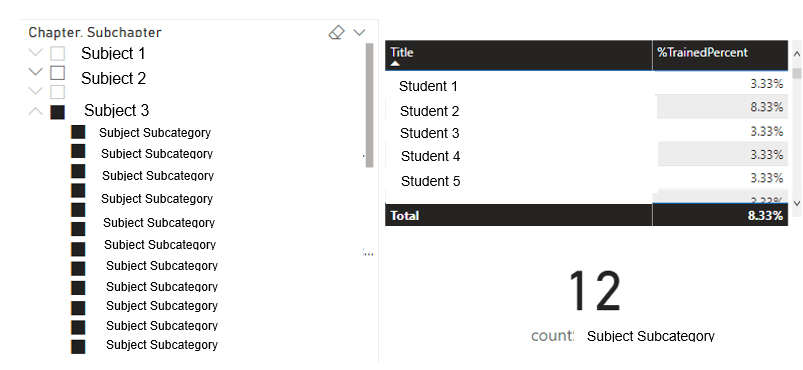

I have changed the information due to sensitivity, The first image as you can see gives the figure I would expect, on the second however when I am aggregating over 12 subcategories it is only picking up 100% as the max when in theory it would be 1200%.

Hi @tamerj1, thank you for your reply, this is so close to the desired outcome! So it is now displaying correct percentages for all of the subchapters added up but it isn't showing the aggregated value. Is there a way to add to this code to divide by count of subchapters selected?

As you can see below for the first student 120% is correct for how much they have scored over all of the subcategories but I am after an aggregation of this so in theory Student one would be displaying 10%. Apologies as my knowledge isn't very extensive but hoping it would be an easy fix! PowerBI_%Trained.PNG
tamerj1
@Altonga
Please try
%Trained =
AVERAGEX (
VALUES ( 'Results'[Chapter] ),
AVERAGEX (
VALUES ( 'Results'[Subchapter] ),
MAX ( 'Results'[Test1%] ) + MAX ( 'Results'[Test2%] )
+ MAX ( 'Results'[Test3%] )
+ MAX ( 'Results'[Test4%] )
+ MAX ( 'Results'[Test5%] )
