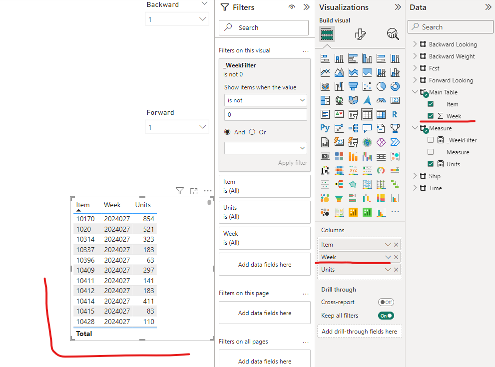

@Anonymous Sorry, I have a follow up question about this table.
It seems I have to add the week from maintable there in the metrics, then I can see the value. If I move the week there, then nothing will show up. (see below)
With Week from Main table
Without Week from Main table
Since I want to identify ABC ranking based on the cumulative units only at item level, is there any way for me to see only Item and related units based on the selected weeks before and weeks after. So I then can add the measure to calculate cumulative units to finally assign A,B,and C ranking based on that dynamic table.
Again, thank you so much, WenBin!
Hi @naoyixue1 ,
Regarding your question, since column 'Item' and column 'Week' have a filtering effect in the DAX expression, they both must be present to filter the data effectively.
