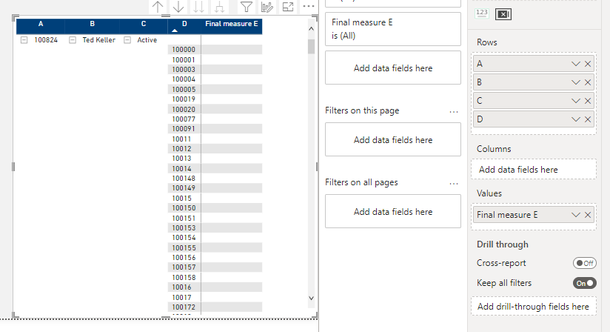

How to display blank at summarized level in power BI matrix
I want to display  the values only at detail level and blank at summarized level in power BI matrix
So when i collapse column C
I wanted E and F to be blank
A, B & C are from first table and  D ,E ,F from second table and the two tables are joined on column A
and as shown A can have multiple values of D (that means second table has multiple instances of A) one to many relationship between 1st and 2nd table
@WTAS80486
Good. Then try
Final Measure E = IF( ISINSCOPE (Table[D] ),MINX(Table, Table[E]),IF(NOT ISEMPTY('Table'),""))

@tamerj1 when I use this
Final measure E=
IF ( NOT HASONEVALUE ( Table[D]), MINX(Table,Table[E]))
I get this when icon is expanded
on collapse
