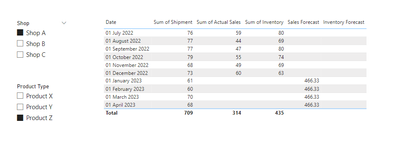

Hi @tamerj1 ,
I have tried to follow your solution with the sample data, but unable to get the correct Sales Forecast values according to the filter context.
Also, the Inventory Forecast values are blank.
Below is the snip without filters
and this one is with filters, having the same values pf Sales Forecast
Thanks,
Saurabh
