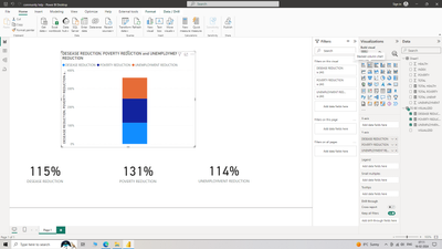

Hello community
I have measures values as following
Poverty = 45%
Disease = 62%
unemployment = 33%
I need to visualize this in Stacked Column Chart
how can I do this , knowing these values are measures , and are not from the dataset table

hi @haniizz
What is the end result that you need?
I need to visualise this way
every category in a column , so in  X axsi we have three values ( poverty reduction - health reduction- unemployment reduction ) three columns , not three in one column is you have shared
hi @haniizz
Can you please show visual handdrawn of what you expect.
Hi Talespin
I'm expecting something like what is in this picture
hi @haniizz
Step1: Create a Category table, and sort Category name by sort column(Column tools > Sort By Column).
Step2 :
Create this measure
Measure By Category =
VAR _SelCategory = SELECTEDVALUE(Categody[Sort])
RETURN IF(_SelCategory = 1, [POVERTY REDUCTION], IF(_SelCategory = 2, [DESEASE REDUCTION], [UNEMPLOYMENT REDUCTION]))
Step3 : In a Stacked Column chart, drop Category on X-Axis and New Measure on Y-Axis.
Hope this helps.

hi @haniizz
You're are welcome.
Dear Talespin
I have an issue when I add more than 3 elements
when I'm trying to add "Education" to the other three elements I get blank column althought all of the measure is correct
hi @haniizz
- You need to add "Education" to Step1 table.
- You also need to modify this measure, add "Education" to IF and call your measure for education.
RETURN IF(_SelCategory = 1[POVERTY REDUCTION]IF(_SelCategory = 2[DESEASE REDUCTION][UNEMPLOYMENT REDUCTION]))
thank you
issue is solved
haniizz
Helper II
Helper II
the table ( to be visulized ) contains the 3 measures that I need to visulize it in stacked column chart
so that ( poverty reduction , desease reduction , unemployment reduction ) are in x axis ,, and their values are in y axis
the pbi file is from here
