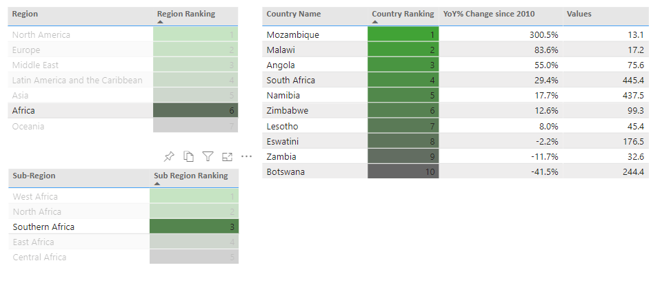

I've hit a roadblock with regards to filtering whilst ranking a column
I have 3 Columns i.e. Countries, Region and Sub-Region which are each ranked by a value, which is working fine and gives me the ranking of the country:
However, when I filter the countries, what I'd like is for the region and sub-region not to default to 1.
Here is an example of the problem: I chose South Africa and region and Sub Region default to 1.
What I would like to ideally see when filtering by country e.g. if I choose South Africa, the Region should display Africa as 6 and Sub-Region as 3. Note that in the below image, I did not select South Africa. If I do select it, then the Region and Sub-Region change to 1.
