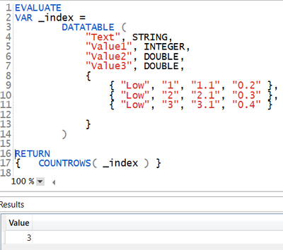

Hi all, I need to create a table inside the measure (not as another table) and get values from there.
If I run as below, it works fine
I see the table is Ok
How to write an expression that works for specific columns?
For example:
MAX(_index[Value2) ... that will return 3.1  ... or
FILTER(_index,[Value1] = 2 ... to select that specifc row
@gdecome , You can try like
MAXX(_index,_index[Value2]))
MAXX(filter(_index,_index[Value2] =2),_index[Value3])
You have use functions which take table name as one of the argument
Thanks @amitchandak but it is not working yet. It is not recognizing the table
Hi @amitchandak , I could solve the problem removing the table name before the column name.
MAXX ( _index , [Value2] )
Thank you for your help
