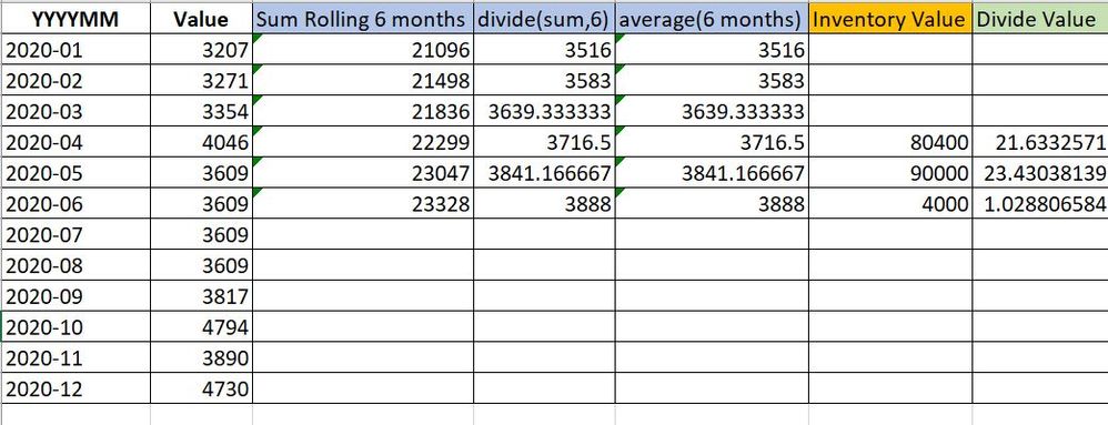

Your method looks much simpler but the 6 month average only works for the first line (26,417). The second line 6 mo average does not compute correctly per your numbers. It should be a rolling 6 months(including current month) calculation. PLease see below.

I am not able to attach the file so here is another screenshot. I got values, but they are not what I expect to get when I test it in excel.
Thank you
Van you share your excel logic? And an example with a difference?

Hope this makes more sense.
Thank you
2 interesting findings;
1. My calculation was missing a 'VALUES' summary.
2. Your spreadsheet does not seem to calculate the average correctly? For the first 6 months it should be 3879,68?

Thanks, @stevedep
The Average works. However, for the Ratio, the math does not work.
6,472/3,879.68 = 1.69, not 1.62.
It looks to be taking the average of the entire table 1 (3987.22); and hence 6,472/3,987.22 = 1.62
I am not sure how to fix that.
Thank you
