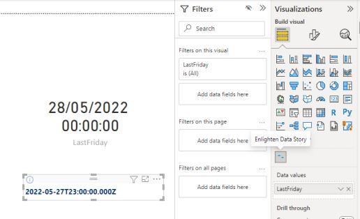

I have a measure and a calculated column, both have the formula: "LastFriday = Today() - Weekday(Today(),1)"
However they return different values. as of today of testing (30/05/2022),
The measure returns 27/05/22 , which is the date I want
The Column returns 28/05/22 Which is annoying.
Is this a known issue? or am I misunderstanding something?
Thanks in advance for any help on this matter

Thank you both for your replies, after knowing which date others got it helped me narrow down the problem.
When I viewed my Visual in "Visual Table" It showed as the 28th, but the display was wrong. (image 1). So i displayed the date on a Card Visual and it shows the 28th!
The Enlighten Data Story Visual I am using is what was causing the display error giving me the 27th! (image2)
Thank you both for the help on this!

@garyhumphreys , I am getting 28th for both
measure
Hi amitchandak
Thanks for your response, Im not exactly sure why mine is showing as it does, when I use the Formula in a measure it gives me a Time value of 23:00. I'm sure this is why I'm getting a different date but I'm unsure as to what is controling this seeing as I use the same formula.
As a column:
As a measure:
