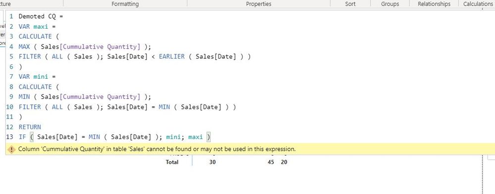

@harshnathani. I tried phormula you said and it shows an error. I think it's because Cummulative Quantity is a measure in the model, instead of a colum.

Hi @Angel ,
Thanks for replying back.
Yes, for my solution to work, Cumulative Quantity has to be a column in the Table. 🙂
Thanks,
Harsh Nathani

Hi @Angel ,
1. Create a Calculated Column (this is to get the Cumulative Totals of the Previous Date)
Demoted CQ =
VAR maxi =
MAX ( Data1[Cummulative Quantity] ),
FILTER ( ALL ( Data1 ), Data1[Date] < EARLIER ( Data1[Date] ) )
VAR mini =
MIN ( Data1[Cummulative Quantity] ),
FILTER ( ALL ( Data1 ), Data1[Date] = MIN ( Data1[Date] ) )
IF ( Data1[Date] = MIN ( Data1[Date] ), mini, maxi )
2. Create a Calculated Column (This Calculates the Difference between the Cumulative Totals)
Difference = Data1[Cummulative Quantity] -Data1[Demoted CQ]
3. Drag your Slicer and Card . Slicer will have the Dates and Card the Difference.
