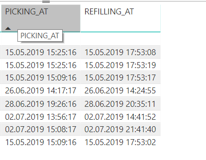

I need to have the Date Difference between two Date columns
# of Minutes = Datediff(OP_ORDER_ITEM_ARCHIVE[PICKING_AT];OP_ORDER_ITEM_ARCHIVE[REFILLING_AT];MINUTE)
I'm using the DateDiff Function but it gives me the following error message:
Query(1,1) Function 'DATEDIFF' is not allowed as part of calculated column DAX expressions on Direct Query models
Can I use it as measure, I know i need to filter the Results somehow by row.
Any help is appreciated
