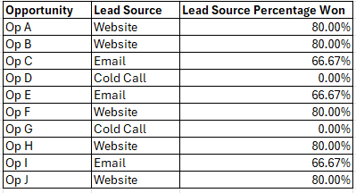

Sorry, it wont let me upload a pbix file which is frustrating. To give you an idea, my data looks like this:
I then create measures to return the percentage of opportunies won which results in this
What I need is a measure that returns the percentage of opportunities won for the lead source of each opportunity. Eg, Opportunities with a lead source 'Website' are won 80% of the time.
Example below -
Hopefully this helps!
Thank you.
Hi @kajelliott ,
You can try below formula:
M_ =
VAR total_ =
        COUNTROWS ( 'Table' ),
        FILTER ( ALL ( 'Table' ), 'Table'[Load Source] = MAX ( 'Table'[Load Source] ) )
VAR cur_ =
        FILTER (
            ALL ( 'Table' ),
                && 'Table'[Status] = "won"
    IF ( ISBLANK ( DIVIDE ( cur_, total_ ) ), 0, DIVIDE ( cur_, total_ ) )
Adamk Kong
Hi @Anonymous
This is perfect! Thank you so much for your time and effort. It is greatly appreciated 🙂
