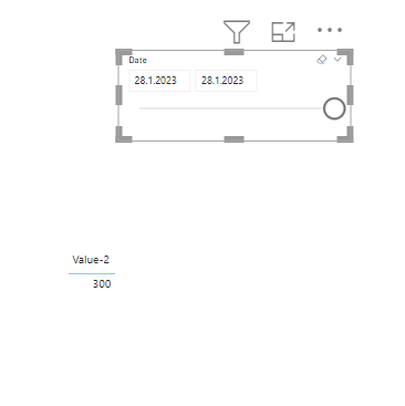

    Example of similar DAX:
    Value-2 = CALCULATE(SUM('Dateadd-2'[Value]),filter(ALL('Dateadd-2'),'Dateadd-2'[Date] in VALUES('Dateadd-2'[Date])))
    By slicing the date VALUES('Dateadd-2'[Date]) will return a blank table and thiss will cause everything else to be blank:
    If we use ALL instead of VALUES the problem is gone:
    Value-2 =
    CALCULATE(SUM('Dateadd-2'[Value]),filter(ALL('Dateadd-2'),'Dateadd-2'[Date] in ALL('Dateadd-2'[Date]))
