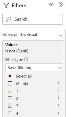

Hi @Anonymous,
Why don't you try using the filters? Select all values first and just uncheck Blank.
Works for you? Mark this post as a solution if it does!
