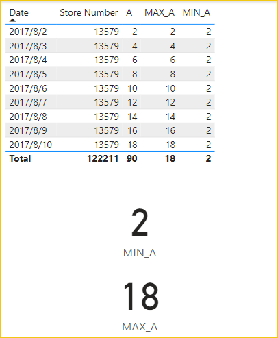

Por favor, pruebe:
MIN_A = MINX(DATESINPERIOD('Calendar'[Date],MAX('Calendar'[Date]),-365,DAY),[A])
MAX_A = MAXX(DATESINPERIOD('Calendar'[Date],MAX('Calendar'[Date]),-365,DAY),[A])
