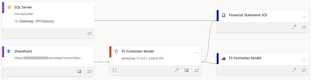

The .rdl file has a couple of SQL query datasets and one stored procedure dataset from the SQL Server and a couple of DAX query datasets from a Power BI dataset (which lives in the same workspace and is ultimately sourced from a few Excel files saved in SharePoint). This is what the lineage looks like:
Lineage
The FS Footnotes Model report works properly in the service and, again, the Financial Statement SOI report works properly in the desktop app but not in the service.

This gateway is used extensively and successfully in other reporting and the Power BI dataset doesn't need a gateway since its data source is in the cloud (SharePoint). I have plenty of other paginated reports that do work in the service but I think all of them are built off of Power BI dataset(s) instead of a mix of SQL Server and a Power BI dataset.
