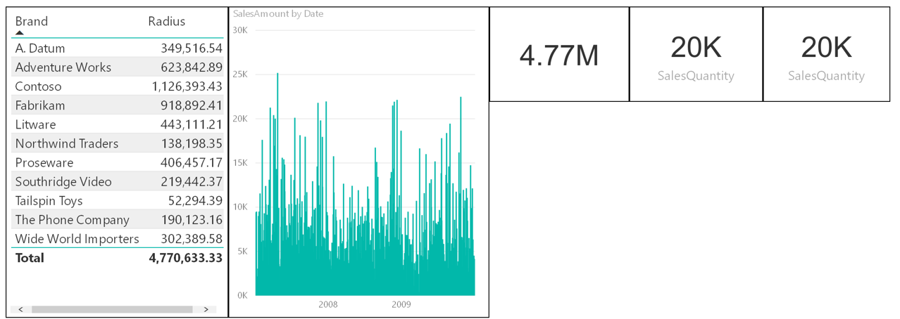

It seems you need to adjust the visuals to make them side by side. My test is fine as we can see from the snapshot below.
Please refer to this documentation.
1. The size is 16:9.
2. I'm afraid the first page is a default page. You can delete it after downloading. I would suggest you create an idea here.

Hi @v-jiascu-msft Dale,
Thanks for responding.
Solution suggested ensures that all visuals appear within the grey box.
It also means that we cannot use the complete canavas available (We need to leave a margin of 20 - 30 px on each side)
This is not specified anywhere in the documentation.
The work-around does not resolve the original issue.
There is no need to include the grey border/ any border for that matter, around the report.
Users typically like to view the PPT the way it is in the report and grey background may not go with the theme (of PPT/ report).
