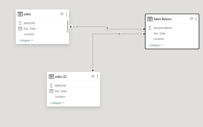

Hi folks, good day! I would like to ask a question on how to fix the relationship between two tables. The problem is that when I click on the slicer date per day, the Amount,  ANOTHER Amount, column drills down by its's data per day, but the Amount Return column does show needed data per day. The Amount Return column is from another table, and I use Many to Many Relationship to it. The Amount column and another amount column work with the many-to-many relationship, but the sales return column does not. Can you give advice on how to fix the problem? It's a big help if you answer my question. Thank you very much. Btw i duplicate a table "sales" from the query so i can connect it from the two table, the drill-down of the data is the amount of location per day. Thanks
Here is the pic for the Relationship Table
The connected first lines in the relation diagram are Doc.date--Doc.Date
The second line is Location--Location
lbendlin
Your question is not clear to me, and your data model isn't one - yet.  Can you identify dimension and fact tables? Where is your location hierarchy?
