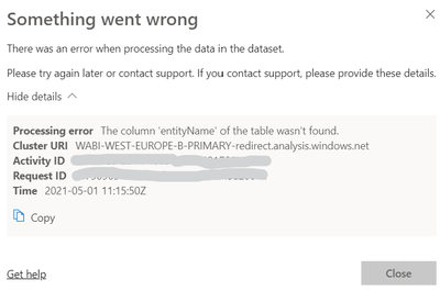

Get Expression.Error: The column 'entityName' of the table wasn't found.
Then in Power BI Descktop I try to connect to any of my DataFlow thru DataFlow (Beta)  get
But no one table on DataFlow has that column
And all reports that was created previously thru works and refresh fine on Power BI service
After choosing dataflows (Beta) - Get Errors for all dataflows
26/04/2021 UPD:
Crashed refreshing all reports with DataFlow (Beta) on server:
@cvillegas
In desktop seems they fixed it. I can connect to Dataflow (beta)
But on server I still get that error in time refresh, for dataset with Dataflow (beta)
That error for credential
4/05/21 UPD: From 2/05/21 there is no error on server. Looks like they fixed bug with dataflow (beta).

Right now I find only one way. In advanced editor (Power BI desktop) replace Dataflow(Beta) by Dataflow as datasource.
And republish it.
EvandroBI
Não mudou nada ainda!
I have found solution.
In Power BI desktop switch Dataflow(Beta) on Dataflow as datasource and republished reports.
27/04/2021 UPD: After republishing all datasets refreshed fine.
