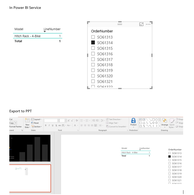

According to the blog, filtered export to PDF and PPT are now available in the Power BI Service. And sure enough, the options are visible in the export dialogue window. However, the output doesn't seem to consider the "export with" value, but instead uses the standard value each time. Anyone else experiencing this?

Hi there, thanks for answering! I can see that this clearly works on your side. However, this is not the behaviour I'm experiencing.
Standard view from PBI ServiceStandard view from PBI ServicePPT export = success!PPT export = success!Changed valueChanged valuePPT export = fail!PPT export = fail!

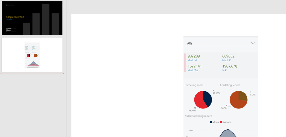

Notice how the export actually not only ignores my chosen value, but is somehow using the "select all" alternative, even though I've turned that off for this controller!
I've tried regular slicer, dropdown slicer, the new single-choice slicer design, the new filter experience, bookmarks - the result is the same. Smiley Sad

You know what? It's working now! I didn't do anything differently, it seems like a bug has been fixed in the PBI service.
Anyways, thanks for your help!
Okay, now I actually got it working on one of my other reports. Could it be some kind of report level setting that I'm missing?
