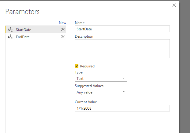

Based on your description, it seems you want to apply query parameter in your stored procedure to retrieve data. We are able to use the query parameter to retrieve data.
However, it's not possible to populate a date picker into query parameter. And we can't only use "Query" type parameter in a query, which means we have to use "Any Value" or "List of Values".

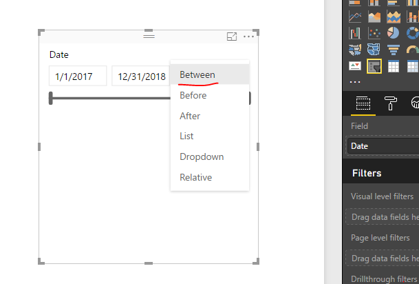

For your requirement, if you just need to filter records between two days, you can directly use a "Between" Data slicer.

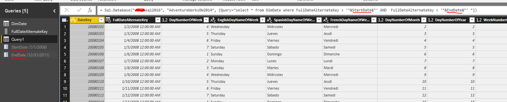

- Anonymous2809Frequent Visitor
Could you please reply in brief I had same kind of situation but I had no date field on main query how can I do this. I need a seperate slicer that is going to call the proc parameters which should be same startdate and enddate. StartDate would be the starting day of year and enddate is todaysdate
