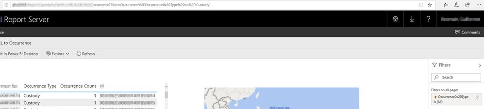

Hi all, I am trying to filter my PBIRS report but it's not working. I am using the syntax ?filter=table/field eq 'value'. It looks like it is understanding the syntax, but it's not passing the value. It's returning the field I am trying to filtering with a caution sign and filtering is(all).
PBRIS is on premise, I was wondering if that's why it is not working?

Hi, I noticed that "occurrence type" in your table is all "custody". It seems that filtering is OK, If not, you should give a counter example to prove that the filter fails (At least I didn't find any problems in the pictures you provided).
For me, PBIRS URL filtering is working (pic as below).
I think you can double check your filter URL and try again.

you need to escape Occurrence Type as
Occurrence_x0020_Type
Thanks for your reply, but your solution didn't work. I am having the same output. I am using pbirs version: 15.0.1103.232. Do you if there is any issues on that version?
try without the percent encodings. Make sure that you spelled both the table name and the column name exactly.
I am trying that: ?filter=Occurrence/Occurrence_x0020_Type eq 'Custody'
The % encodings is automatic generated after running the URL.
