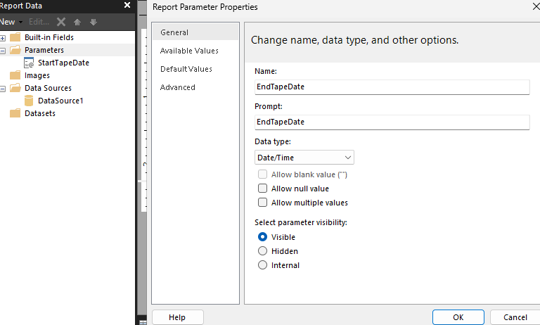

Use Microsoft Report Builder/Power BI Report Builder
After the data source is successfully connected, the parameters used in the four table value functions are created
Add a Dataset(It is actually a call to a table function in SQL Server)
SELECT * FROM dbo.RateAttributionReportNmd (@StartTapeDate, @StartVersionId, @EndTapeDate, @EndVersionId)
Add a table to display the data
The final presentation results are as follows:
Parameter settings in paginated reports are very important.
You need to check that you have the right type of parameter, that the parameter requires a manually selected value, and that there is no default value.
What is the way to get the default value (by giving a default value directly or by querying from Data Set)
If you need the selected value of the parameter to be queried from the Data Set, then you need to set up a separate Data Set for these parameters to get the data, and isolate it from the Data Set of the main table data to avoid cross-references (circular dependencies)
Parameter mappings in the dataset also need to be scrutinized
I hope my suggestions give you good ideas, if you have any more questions, please clarify in a follow-up reply.
