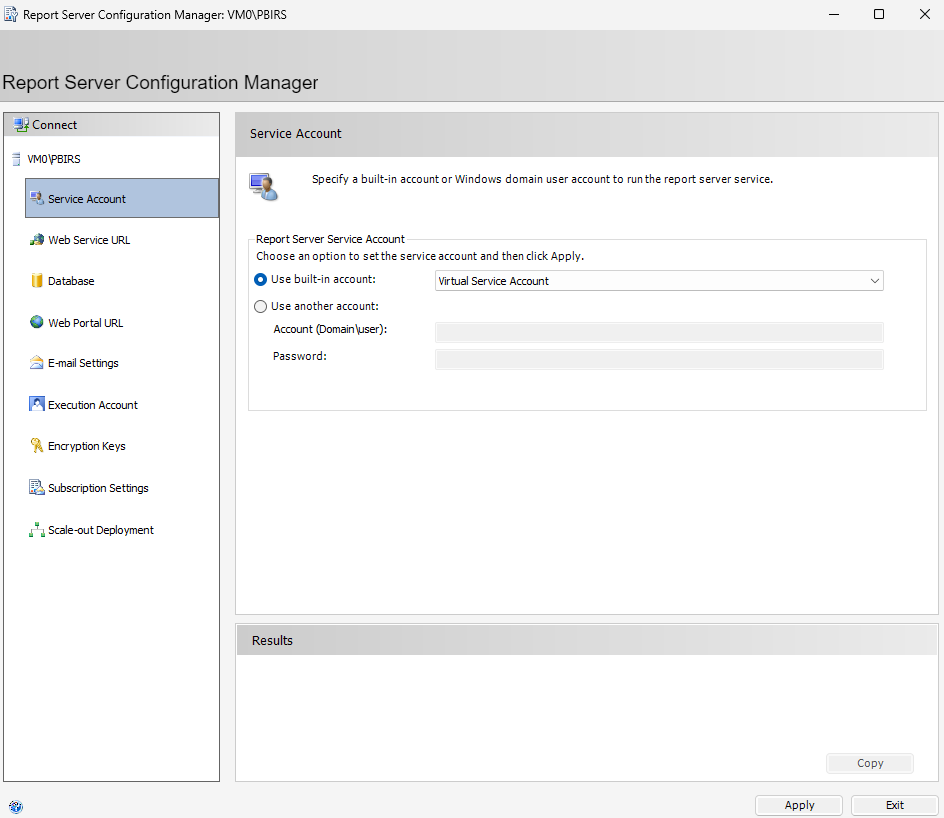

Here are the results of my tests:
1. Clear your browser cache
2. Clear all encrypted content and reconfigure Report Server Configuration Manager.
3. Pay attention to the on/off status of the server
4. Choose the appropriate service account (I chose Visual Service Account here)
5. Set the appropriate Web Service URL
6. Select the server database you need to modify, and modify the default server database credentials (highlights)
Choose the appropriate authentication method (I chose Integrated Security)
Select the appropriate credentials (I chose SQL Server Credentials) The account uses the default account SA for all databases
At this point, after successful configuration, you need to ensure that the browser cache has been cleared, restart the report server management tool to open the local server, this time the user then logged on to the local report server through the browser requires logging in to the local account, you need to enter the account password to verify that the report server can be accessed only after the passage of the report server, the realization of your needs!
