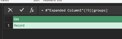

I am importing some data using an API, it comes as JSON and I can get the data I need from that until I get to the group(s) that each item is a member of.
each item can be a member of zero or more groups. if that number is zero it appears to enter a null value, for the others it has a record for each item with name & id.
this is what each list holds:
each record has two fields
except when its not in any groups and then it puts a null value in the row
when I try to expand that, either by using the GUI or a custom column it errors because it cant transform type null.
In other (similar) circumstances I would replace the null value, but I don't get that option.
Is there any method to expand this column (groups) to show its values without losing rows?
