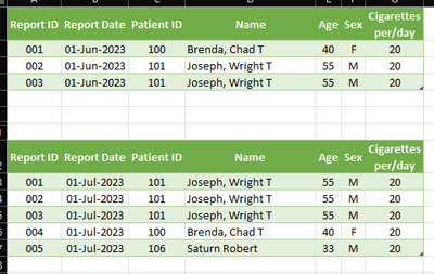

Output from your two files
Thanks for the reply. Sorry I am not doing well.
