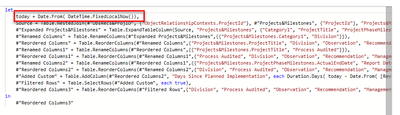

      Firstly, I'm hoping to be able to incorporate the today query/results into a custom column in an expsting query that I'm using to generate an Excel report:
      Secondly, the query with the source data (i.e., the two fields used in the calculation) has 9 rows of data but the results of the today query only return 2:
      How can I incorporte the today query into the main query and have it apply to all rows so that I get the aging for all records?
      Thanks again for your help.

        Go to your excisting query and open the advanced editor. From the sample provided, copy the first line of code and paste that above the first line of code in your query. That's this bit.
        today = Date.From( DateTime.FixedLocalNow()),
        Close the advanced editor and use the user interface to add a custom column. In the dialog, give that new column a proper name and copy this bit into the code section.
        Duration.Days( today - (Date.From( [Revised Implementation Date] ) ?? [Original Estimated Implementation Date] ))
        If your column names do NOT match, select that field reference in the code section, delete it and double click the correct field from the field list on the right  hand side to replace it.
        Done.
