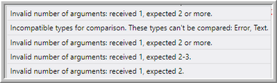

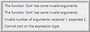

For some reason, the minute I add "Distinct", that's when I get an error. If I remove the Distinct portion of the code you gave me, it works perfectly. I will try again and get back to you, but for now, no luck.
I tried again, and when I add the Distinct code piece, I still receive the same errors:
I'm confused as to why this is happening.

For some reasons, i'm still having all those errors
