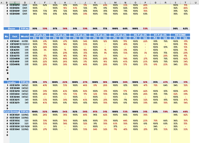

Greetings,
I have a raw data like this, it shows a unit type, unit id, and its performance (PA and UA)  per-date
notice in row 3 there is data containing date, and below it (row 143) there is also a date
i want to transform it to something like this
tried transpose it but it doesn't sync with other data, how can i do it?
Any suggestion will be appriciated, thanks!

Update:
i manage to somehow transform it using unpivot column, but the problem is the date is only from 26/1/26 to 31/1/26, after that date it isn't detected.
the query before unpivot:
the query after i unpivot the column
how do i make certain row (like row 139 which contain date) to make it header in other column so i can unpivot it?
Hi, i still lost after the first line of code (which is remove header). here is what the original data look like
below this data there is a table similar like this, but with different date (8 - 14 february 2026)
and here is the query
in column 5 contain multiple data type (date, number, and text)
date: 26/01/26
number: 1, 0.98, etc
text: pa
how do i transform it like this?
