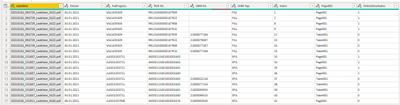

I have a dataset of loading lists of orders. It looks like this:
 For the given Loading list (Ladeliste) I want to remove duplicate NVE numbers (shipping unit number) but only those that have empty values in LHM number column (loading unit ID). If a corresponding cell in LHM-Nr. column is not empty I want to keep it. For example, when removing duplicates in rows 2 and 6, I want to remove row 2 since LHM-Nr. column cell is empty. Correspondingly, between rows 3 and 7 I want to remove row 3.
This is how the resulting table should look:

  • Okay, please try this.  I have included comments that explain each step.
    BEFORE:
    The goal is to remove rows 1, 3, 6, 8 and to have all columns present in the result.
    RESULT:
    SCRIPT:

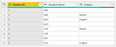

  • Hello - here is an option for returning the result.
    I have created a sample table with similar specs.  The goal is to keep rows 2, 3, 5, 7, 8.
    BEFORE
    AFTER
    BEFORE
    AFTER
    SCRIPT
        Source = Table.FromRows(Json.Document(Binary.Decompress(Binary.FromText("i45WMlTSUXJ0cgaSSrE6yFzfxJKMYrCYEZDn5OwCJF3z0nMyizPQRMFcYyDD2cUVRSNCDMw1ATJcXN1gXFOQgW7uyMbGAgA=", BinaryEncoding.Base64), Compression.Deflate)), let _t = ((type nullable text) meta [Serialized.Text = true]) in type table [#"Student ID" = _t, #"Student Name" = _t, Subject = _t]),
        #"Changed Type" = Table.TransformColumnTypes(Source,{{"Student ID", Int64.Type}, {"Student Name", type text},  {"Subject", type text}}),
        #"Grouped Rows" = Table.Group(
            #"Changed Type",
            {"Student ID", "Student Name"},
                { "Subject", each List.First ( List.Sort ( _[Subject], Order.Descending ) ) },
                { "All", each _, type table [Student ID=nullable number, Student Name=nullable text, Subject=nullable text]}}
        #"Grouped Rows"

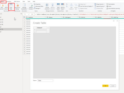

      Hi, Anonymous
      Here is a sample data file. I did the grouping exactly as per jennratten's solution. If you expand the table you will get exactly the same table as before the grouping.
      The file can be found here. I created a .pbix file but it would produce an error when opened on another pc since the source files (pdfs) are on my pc. The resulting table I put into the same folder:
      https://docs.google.com/spreadsheets/d/1DxeOckz_5eTte3wUdyDUcmXC5zCGXIbW/edit?usp=sharing&ouid=107609193436761136051&rtpof=true&sd=true,
      https://drive.google.com/file/d/1kLj8vwUHDV14X2S273cIGtkbVLVLMXpc/view?usp=sharing
      Please let me know if you need anything else.
