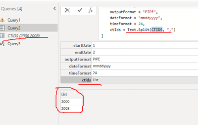

--I have some information saved in Power Query under Manage Parameters. I want the CTIDs to be a managed parameter too, but the format in the m code is ctIds = {"2000","2008"} How would I enter that into the managed parameters and/or change the m code so it is formatted properly?
The Parameters can't show the list, so you must revise the code in Advanced Editor. maybe you can enter text, then split it.

The solution for the CTIDs worked using the list and Text.Split (yay!)

// If the result meets the requirements, set status to true and get the result
r2 = if r1 <= 0.1 then [status = true, result = r1] else s
r2
fx("arg_test", 3)
Thank you so much. You were a great help!
