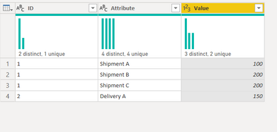

@ngct1112  you can transform it this way
    Source = Table.FromRows(Json.Document(Binary.Decompress(Binary.FromText("i45W8nRR0lHyS8xNBVJhiTmlqUqxOtFKhkCec2JJanp+USWQGZyRWZCbmlcCl/MsSc0FUo5wgYCizGSQEYYGBuiKnDAUGWEqcsapyAjVKS6pOZllqUAmTA7FKUbITjEFGhALAA==", BinaryEncoding.Base64), Compression.Deflate)), let _t = ((type nullable text) meta [Serialized.Text = true]) in type table [Column1 = _t, Column2 = _t, Column3 = _t]),
    #"Promoted Headers" = Table.PromoteHeaders(Source, [PromoteAllScalars=true]),
    #"Filtered Rows" = Table.SelectRows(#"Promoted Headers", each ((try Number.From([Value]) otherwise -999) =-999)),
    #"Added Custom" = Table.AddColumn(#"Filtered Rows", "Custom", each if [Name]="Category" then [Value] else null),
    #"Filled Down" = Table.FillDown(#"Added Custom",{"Custom"}),
    #"Filtered Rows1" = Table.SelectRows(#"Filled Down", each ([Name] = "Item")),
    #"Removed Columns" = Table.RemoveColumns(#"Filtered Rows1",{"Name"}),
    #"Merged Columns" = Table.CombineColumns(#"Removed Columns",{"Custom", "Value"},Combiner.CombineTextByDelimiter(" ", QuoteStyle.None),"Attribute"),
    _1 = Table.ToColumns(#"Merged Columns"),
    _2 = Table.SelectRows(#"Promoted Headers", each ((try Number.From([Value]) otherwise -999) <>-999))[Value],
    colName = List.Combine({Table.ColumnNames(#"Merged Columns"),{"Value"}}),
    Custom1 = Table.FromColumns(_1&{_2},colName),
    #"Changed Type" = Table.TransformColumnTypes(Custom1,{{"Value", Int64.Type}})
    #"Changed Type"
