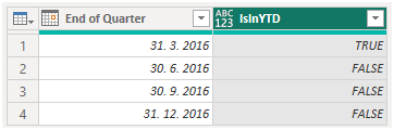

Hi @Anonymous , you haven't specified expected output. What about this one?
    Source = Table.FromColumns({List.Transform({3,6,9,12}, each Date.EndOfQuarter(#date(2016,_,1)))}, type table[End of Quarter=date]),
    Ad_Check = Table.AddColumn(Source, "IsInYTD", each Date.IsInYearToDate(#date(Date.Year(DateTime.FixedLocalNow()), Date.Month([End of Quarter]), Date.Day([End of Quarter]))))
    Ad_Check
