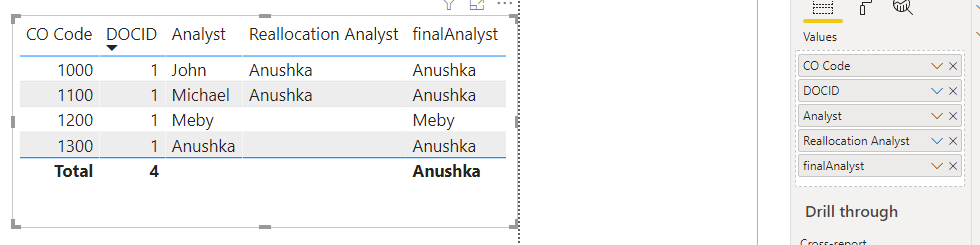

Hi @AhmedIqbal ,
Sorry, I wasn't in front of my computer when I sent that measure. Try this one:
finalAnalyst =
IF(
  ISBLANK(MAX(Reallocation[Reallocation Analyst])),
  MAX(Allocation[Analyst]),
I get this output:
Pete
Now accepting Kudos! If my post helped you, why not give it a thumbs-up?
Proud to be a Datanaut!
