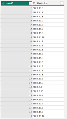

Hi Team,
Here based on the Isssue Id column we need to fetch max value of Fixversion and remove Other records.
Description: Issue ID - 2 is having multiple FixVersions ( SFP.R.11.7, SFP.R.11.8 & SFP.R.11.9 ), but i want to fetch only one record for each Issue ID with Max FixVersion like below
The code I supplied earlier seems to work with your new sample:

But Power BI Consider SFP.R.8.9 as max string Compared to SFP.R.11.8 ( but this is the newest version right and Max Stiring). See Key -> SMAR-2363
I don't understand your two comments.
Version SFP.R.11.8  is a later version than SFP.R.8.9 and my code reports it as such.
Also, in your example, there is no column labeled "Key" and no entry SMAR-2363 so I have no idea what you are referring to.
Please clarify both points.

I cannot reproduce your issue with the code I have provided and the examples you have provided. As you can see, the results show SMAR-2363  -  SFP.R.11.8 which you have noted is correct:
Version Table:
Issue IDFixVersion
1 SFP.R.11.8
2 SFP.R.11.7
2 SFP.R.11.8
2 SFP.R.11.9
3 SFP.R.11.7
3 SFP.R.11.8
3 SFP.R.11.9
3 SFP.R.11.10
4 SFP.R.11.8
5 SFP.R.11.8
6 SFP.R.11.8
7 SFP.R.11.8
8 SFP.R.11.8
9 SFP.R.11.8
10 SFP.R.11.8
11 SFP.R.11.8
12 SFP.R.11.8
13 SFP.R.11.8
14 SFP.R.11.8
15 SFP.R.9.9
15 SFP.R.9.10
15 SFP.R.10.1
15 SFP.R.10.2
15 SFP.R.11.7
15 SFP.R.11.8
15 SFP.R.11.9
15 SFP.R.8.9
SMAR-2363 SFP.R.11.8
SMAR-2363 SFP.R.8.9
SMAR-2363 SFP.R.9.9
Code: (altered only to change version column name to `MaxVersion`, and Issue ID column type to `any`)
    Source = VersionTable,
//Split digit and letter parts
    #"Split" = Table.AddColumn(Source, "SplitParts", each
            split = Text.Split([FixVersion],"."),
            letter = Text.Combine(List.Range(split,0,2),"."),
            digits = Number.From(split{2})*1000 + Number.From(split{3})
            [letters=letter, digits=digits],
            type [letters=text, digits=Int64.Type]),
    #"Expanded SplitParts" = Table.ExpandRecordColumn(Split, "SplitParts", {"letters", "digits"}, {"letters", "digits"}),
    #"Grouped Rows" = Table.Group(#"Expanded SplitParts", {"Issue ID"}, {
        {"Latest Version", each Table.Last(Table.Sort(_, {{"letters", Order.Ascending}, {"digits", Order.Ascending}}))
        , type [Issue ID=any, FixVersion=text, letters=text, digits=number]}}),
    #"Expanded Latest Version" = Table.ExpandRecordColumn(#"Grouped Rows", "Latest Version", {"FixVersion"},{"MaxVersion"})

Hi it helps. But If we have some more data like in the screenshot. Pls have a look.
  1. I need more help on this & how it can be done.
  2. If Issue ID is same, I want only one Issue ID with Max FixVersion Record
  3. Note: FixVersion from Least to Highest ( 8.1,8.2,....,8.10,8.11, 8.12..,   11.1, 11.2,....,11.10, 11.11, 11.12.., )
