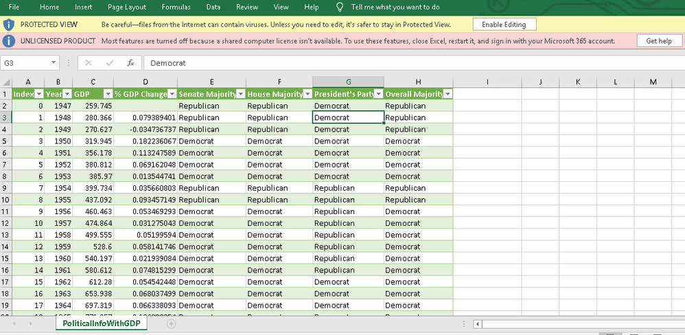

How to reproduce steps in PowerQuery?
My goal is to reproduce the steps for getting a dataset... I know how to do that in PowerBI, but not in Excel, how can I reproduce the steps in PowerQuery to get this?
I am also not sure why do I get a UNLINCENSED PRODUCT since I am using the DSVM from Azure...

  • Perhaps I stated wrongly my question. There is no PowerBI, I have that excel file with that dataset, I want to know what transformations that dataset had to get that final state.

  • Hi PhilipTreacy
    Let me give some context, I am reading 'advanced analytics in power bi' book, and the author says: "The xlsx workbook contains the data sets and the Power Query queries that were used to create the data set used"
    Then, says: "The hard work has been done for you, but you can inspect the workbook to see how the following data sets were combined to produce the PoliticalInfoWithGDP data set."
    I want to be able to reproduce those steps...
    So, If I were in powerbi, I could open power query I can see the 'applied steps' section... I was looking for something similar but in Excel...

      Hi marma330 ,
      In Excel, in the "Data" tab, go to "Get Data" and "Launch Query Editor".
