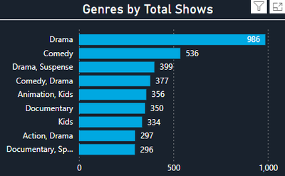

    jennratten I have now managed to create the list and expand the rows into two new tables as you suggested. I have established the one to many connections and have been able to improve upon the bar chart from the original dashboard as you can see below.
    Just curious though, in what scenario would I need bridging tables as per your example?
    Original
    Improved
