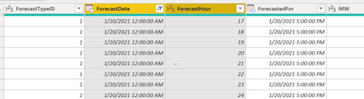

Hi, Can you help with this,
I would like to combine these two columns forecastdate and forecast hour together as a date time . Thank you. i tried your code for this but it is giving me errors
AlB
@gaikwadaa123
Who are you asking?
Try this in a custom column:
= Date.From([ForecastDate]) & #time([ForecastHour],0,0)
Please mark the question solved when done and consider giving a thumbs up if posts are helpful.
Contact me privately for support with any larger-scale BI needs, tutoring, etc.
Cheers
SU18_powerbi_badge
This worked like charm. Thank you so much. appreciate it.
