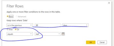

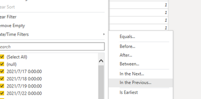

    Filter the with previous 30 days should work.
        Source = Table.FromRows(Json.Document(Binary.Decompress(Binary.FromText("hZJBCsMwDMC+MnIuxHbWVdtXSv//jV7WMlaN3YIIGNla11ZR2Zc+bvGKaFPLtk0nvSudlT6ULkpR+lSa4Tgdl2P3SxdMN0xXTHdMl8wvy+vj/bHcpNyk3KTmf9N+zh++92F7pzs1BbQ1tDW0NbQ1tDW0NbQ1vDW8Nbw1vDW8Nbw1vDW8Nbw1Lq0dV/m03HY=", BinaryEncoding.Base64), Compression.Deflate)), let _t = ((type nullable text) meta [Serialized.Text = true]) in type table [Date = _t, #"1" = _t]),
        #"Changed Type" = Table.TransformColumnTypes(Source,{{"Date", type datetime}, {"1", Int64.Type}}),
        #"Filtered Rows" = Table.SelectRows(#"Changed Type", each Date.IsInPreviousNDays([Date], 30) or [Date] = null)
        #"Filtered Rows"
