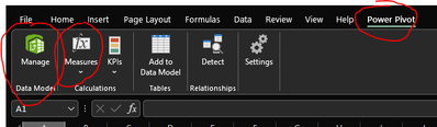

Hi @shekhar_shres ,
Ok. Very difficult to give you the best option for you without fully understanding your exact scenario, but here's my thoughts on what you've provided:
You can still build a data model in Excel and create DAX measures:
I'm assuming you are on Office 365 and/or have the latest version of Excel but, even if you don't, you can get Power Pivot as an ADD-IN. I think this is what you'll need to do if you're worried about making multiple calls to your SQL server.
Using Power Query to generate these 30 tables, no matter how you do it, is in most circumstances going to result in ~30 calls to the server. That how PQ works. If you want to pass the load to the end user, you will need to only bring the source table through from Power Query, then use DAX to create the 30 tables (which could be very resource-intensive on the end user machine) and/or use DAX to create measures against the source table (far less resource-intensive).
As I said before, I can't really imagine a scenario requiring the spawning of 30 new tables from a single source table which couldn't be largely negated using DAX, but without further detail I can't help here.
